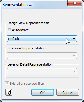

You can change the design view representation for an existing presentation view.
You can control associativity between the presentation view and the definition of the design view representation in the model file.
In the Representations dialog box:
