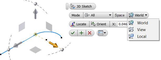

3D Transform
The 3D Transform command is added to the 3D Sketch environment, Modify panel. The new 3D Transform command provides a robust set of geometry manipulation tools.
Use the new command to freely or precisely move or rotate the geometry. You can also set options to reorient the triad or manipulate the geometry based on the World, the current View, or the Local coordinate system.
