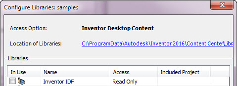

A new Content Center library for IDF components installs with the 2016 R2.
You can now build an IDF component library in Inventor:
  • Author and publish parts with the new Manage Author IDF Component command to the new IDF Component Content Center Library.
  • When you import/open an IDF file, all library components in the IDF Component Content Center Library are automatically reused in the import.
