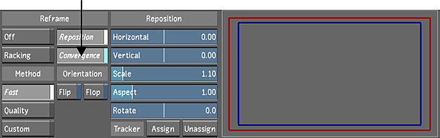

  3. Display the Reposition menu. See Accessing the Reposition Menu.
  4. Enable Convergence.
    Note: In the Preview window of the Reposition menu, the image reference (i.e., the blue rectangle) is for the assigned eye only.
  5. Use the Reposition sliders to converge the shots. The other eye will be offset in the equal and opposite manner.
