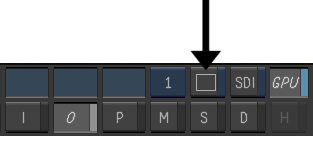

To enable the viewing options:
  1. Enable the Viewing Options button. The look of this button depends on the viewing option that is currently selected.

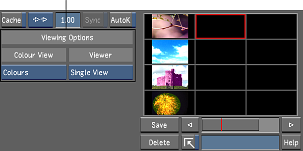

    The Viewing Options panel appears to the left of the Grade bin.
  2. Select the colour view option.
    Cycle through the following options:
    • Colours
    • Red Channel
    • Green Channel
    • Blue Channel
    • Luminance
  3. Select the number of shots to view using the Viewer option box.
    Select: To display:
    Single View The default viewer. The viewer displays the image of the current playhead.
    Dual View The images of Playhead A and Playhead B. See Using Dual View. For a stereoscopic project, it displays either Playhead A and Playhead B, or the Left Eye and the Right Eye. See Viewing Stereoscopic Footage in Dual View.
    Multi View 2, 4, 9, or 16 shots. See Using Multi View.
