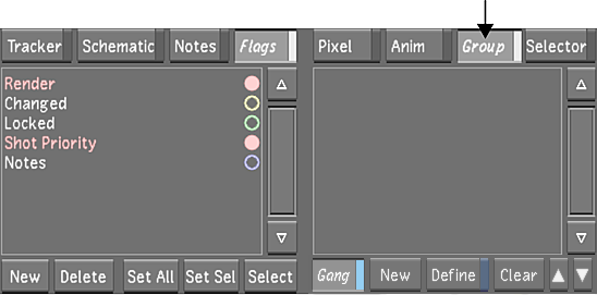

To create a shot group:

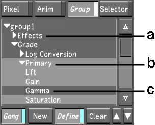

A new group called group1 is created and the Define button is enabled. This allows you to add shots to the shot group and select the parameters that are applied to the grouping.
Grouped shots are highlighted with a yellow border.
(a) Deselected directory (b) Selected expanded directory (c) Selected channel
