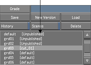

  2. From the Grade list, load the grade from which you want to create a real-time deliverables setup.

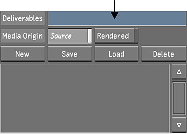

  5. In the Deliverables field, enter a name for the setup.
  6. Click New. The setup name is added to the list of setups for the grade.

  11. Click Save to save the setup.
    The setup is saved to the scene's Library folder as an XML file. The file uses the real-time deliverables setup name, preceded by the name of the grade on which it is based. For example, if the grade name is grd01, and the setup name is My_HD, the XML grade file is [grd01]My_HD.deliv.xml.

  1. In the Deliverables section of the Grade menu, select a setup from the list and click Load.
    This loads both the grade and the setup.
To load a setup to a different grade:
  1. In the Grade menu, load the grade on which you want to apply the existing deliverables.
  2. Select a setup from the list, and press Ctrl while clicking Load.
    This loads the setup to the grade.

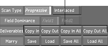

Sharing Modifications Between Setups and Grades
By default, unrendered changes to a grade file are not applied to real-time deliverables setups, and modifications made to a setup are not copied back to the grade. However, you can force changes to be copied back and forth either on a shot-by-shot basis or for the entire scene.
To share modifications between setups and grades:
  1. In the Grade menu, click one of the Deliverables buttons.
    Click: To transfer:
    Copy In Modifications made to the current shot from the grade to the setup.
    Copy In All Modifications made to the scene from the grade to the setup.
    Copy Out Modifications made to the current shot from the setup to the grade.
    Copy Out All Modifications made to the scene from the setup to the grade.
