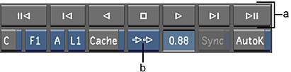

  2. Click the Play Mode button to cycle through playback range options.
    (a) Playback controls  (b) Play Mode button  
    Select: To specify a looped playback range:
    Of the entire timeline.
    Of the current shot.
    Between in and out points.

  4. Use the following playback controls or hotkeys to play your shot forward or backward.
    Click: Or press: To:
    Right Ctrl during playback Play the cut forward.
    Right Alt during playback Play the cut backward.
    Alt + N/A Low Latency playback mode (without audio), which removes the delay between DVI and SDI (AJA SDI Preview only).
    N/A Stop playback.
    N/A Spacebar Start or stop playback in the direction last played.
