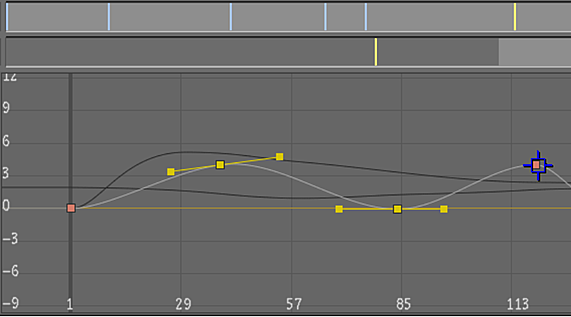

You need to select keyframes in order to edit them. You can select one keyframe at a time, marquee select a group of keyframes, or select all keyframes in a given channel.
Selected keyframes are yellow. Unselected keyframes are red.
To select a keyframe:
The keyframe is selected.
Once selected, you can right-click on a single key frame and modify its value with the on-screen calculator. It is also possible to enter a number on the calculator and use the up/down arrows to interactively modify the value.
To select multiple keyframes:
If you release the Ctrl key and then click a keyframe, this keyframe is selected and the previous selection is cleared.

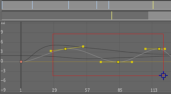

To marquee select multiple keyframes:
Keyframes inside the marquee selection are selected.
