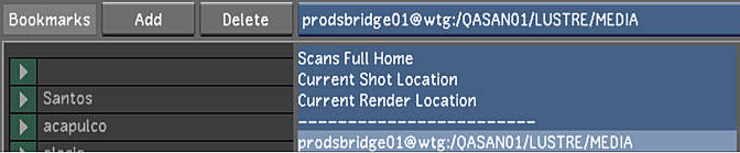

You can quickly access file system folder locations using bookmarks. Bookmarks can be applied to local or remote file system folders, Wiretap and Wiretap Gateway server.
The Bookmarks box contains three default shortcuts.
- Scans Full Home navigates to the project Scans Full Home location.
- Current Shot Location navigates to the folder location of the source media for the current shot.
- Current Render Location navigates to the folder location of the rendered media for the current shot.

A new entry is added to the Bookmarks box.
To navigate to a folder using bookmarks:
- Click the Bookmarks box.
- Select the bookmarks with the location where you want to navigate.
