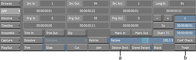

(a) Delete Shot button  (b) Trash button  
To delete a shot from the Storyboard:
  1. Click Editing, and then click Edit to display the Edit menu.
  2. Select the shot, and then do one of the following:
    • Click Delete Shot and then confirm the deletion.
    • Click and drag the shot to the Trash button, and then confirm the deletion.
    • Press Shift+D.
    The selected shot is deleted.
