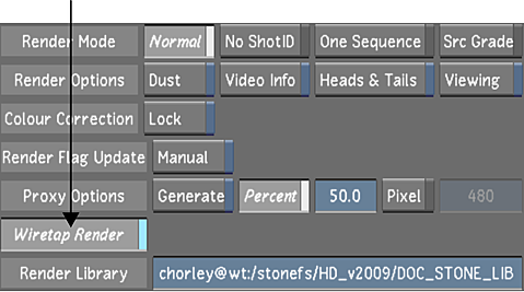

You can create soft-imported clips from rendered material and write the generated timeline back to the Wiretap Clip Library. The rendered results reside in the destination specified in the project settings, and a soft-import link is created on the Stone FS or Standard FS.
To create a soft-imported link to your graded renders in the Wiretap Clip Library:
For example, if your Windows drive is mapped to the network storage as S:\, then the renders full home path should be S:/SAN/lustre_renders.
For example, 10.145.43.31@wt:/stonefs/project/library.
Note that you can set a default value for the Render Library field when configuring the project, as described in the next procedure.
This renders the files to the specific path of the shared network storage, and publishes the soft-import links to your rendered files in the destination Wiretap clip library. A new scene grade reel containing the soft-imported clips and/or timeline is created in the location specified by the Render Library field.
To set the Render Library path as a project setting:
<Wiretap_server> @wt:/ <volume> / <project_name> / <library>
For example:
rishikesh@wt:/stonefs/HD_project/lustresmoke
The path appears in the Render Library field.
