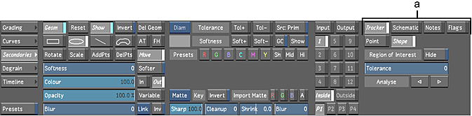

Parts of the Shape Tracker
The Shape Tracker is made up of the following components.
(a) Tracker button (b) Tolerance slider  (c) Shape button  (d) Hide button  (e) Analyse backward button  (f) Analyse forward button  
Tracker button
Enables the tracking option (Point Tracker or Shape Tracker).
Tolerance slider
Defines the tolerance level of the Shape Tracker analysis. The range is from 0 to 10.
A tolerance level of 0 (low tolerance) means the object that is being tracked does not change in shape throughout the shot. If an external object passes in front of the tracked object, a low tolerance ensures that the motion of the external object does not get tracked through the analysis.
A tolerance level of 10 (high tolerance) means the object which is being tracked has a slight change in shape throughout the shot. For example, there is slight 3D movement from the shape. If you have set the tolerance level to high, external objects that pass in front of the tracked object may be included in the analysis.
Shape button
Enables the Shape Tracker tool.
Hide button
When enabled, it hides the selected geometry and grading (if applicable). You can also use the hotkey, left Ctrl+H, to hide and show the geometry.
When selected, the Shape Tracker analyses the object within the selected ROI from your insertion point to the beginning of the shot.
When selected, the shape tracker analyses the object within the selected ROI from your insertion point to the end of the shot.
