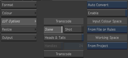

Using Auto Convert
Auto Convert: This option lets you to select the Input and the Working spaces and then converts the pixels from the Input Space to the Working Space. Images are tagged as being in the Working Space.
From File or Rules: When using the Auto Convert colour management mode, you can manually select an Input Colour Space or you can select From File or Rules. What this does is analyze in the media file for a readable colour space, if none is found, it defaults to the current Input Rules and uses the first rule that matches the media.

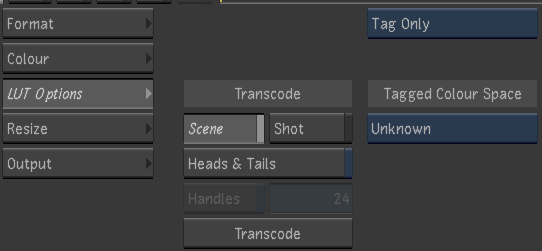

Using Tag Only
Tag Only: This option lets you set the Colour Space tagging metadata for clips but does not modify the pixels.
Note: When importing content from Wiretap server, the tagged Colour Space metadata from Flame is displayed in this menu and can be modified if required.
