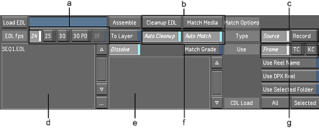

    The Assemble menu appears.
    (a) Frame Rate buttons  (b) Manual options  (c) Base of assembly buttons  (d) EDL list  (e) Log window  (f) Assemble options  (g) Timecode buttons  

  5. Determine the base of assembly by enabling one of the following.
    Source
    Recreates a timeline according to how the source footage was arranged.
    Record
    Assembles the timeline using the timecode of the final edited clip.
    Note: If you selected Record as your base of assembly and your shots include dissolves, enable First-Last Key Anim Type on the Setup page of the Animation menu. See Synchronizing Keyframe Functionality.
  6. Click the Frame Rate button that corresponds to your EDL's frame rate. The following frame rates are supported.
    Enable: To:
    24 Load a 23.98 or 24 fps EDL.
    25 Load a 25 fps (PAL) EDL.
    30 Load a 29.97 or 30 fps (NTSC) EDL.
    30 PD Convert an NTSC EDL to 24 fps and load the converted EDL.
    DF Load a 29.97 fps drop frame mode (NTSC) EDL.
  7. Enable Match Name to match the timecode and tape name in the EDL to your shots.
    Lustre tries to detect the Tape name in the EDL to the shots' directory path. This path is fixed—the correct directory should be one level above the resolution directory. For example, if the tape name in the EDL is BTE164, the matching shot is at:
    < HOME >\scans\BTE164\2048x1556\0002487.dpx
    Tip: To match the EDL reelname to the reelname in the DPX header, enable the Use Reel Name button in the System & Menu page of the user configuration. See System & Menu Settings.
  8. Enable Dissolve to include any dissolves in the EDL.
    Note: Only dissolve transitions are supported when loading an EDL. Other transitions are replaced by cuts.
    Danger: Continuing this process creates a new cut from the EDL. If you have not saved your work, it will be lost. Therefore, it is a good idea to start from an empty cut before loading an EDL.
  9. Enable either Frame or Timecode depending on how you want Lustre to read the shot's timecode when assembling the EDL.
    • Enable Frame to convert the shot filename to a timecode value.
    • Enable Timecode to use the timecode value stored in the file header.
    Note: For information on Keycode assembly, see Keycode Assembly.
  10. Click Load EDL.
    The system checks to make sure that the EDL is a valid CMX3600-formatted EDL. If the EDL is not valid, a message appears in the Load log and the EDL is not loaded.
    Note: ALE and Cutlist files are also valid. See Keycode Assembly.

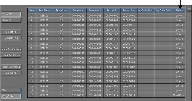

    The matching process links EDL event timecodes to media timecodes in the Library. The match status is indicated in the Media column of the Assembly window. Successful matches are indicated by a Linked status, whereas unsuccessful matches generate a Need Match status.
