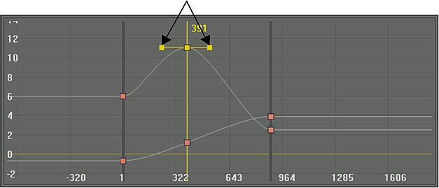

To modify the shape of an animation curve:
A pair of Bezier tangent handles appear for the selected keyframe.

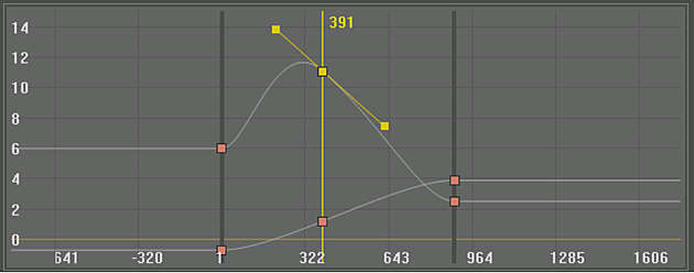

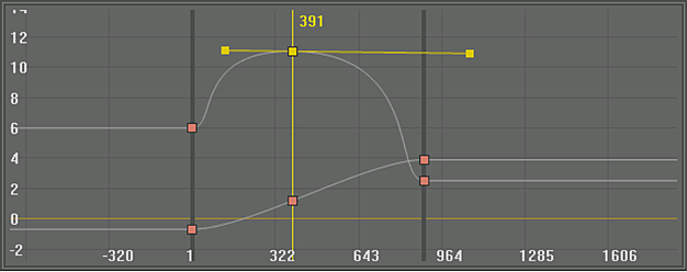

The shape of the curve changes as you move the tangent handle.
