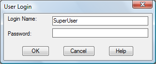

To log in as SuperUser
Find
. Find
Log in as SuperUser to define object classes.

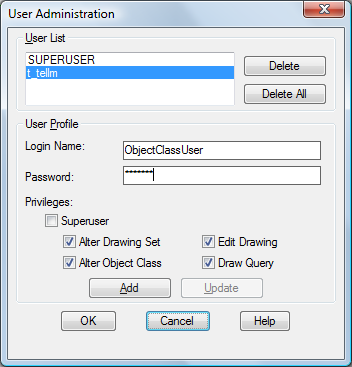

To create a user
Find
. Find
Click
Find
. Find
If someone else in your organization is the designated SuperUser, ask that person to do these steps.
If you cannot log in as SuperUser, log in as a new user with the privileges to create object classes.
You set up the privileges necessary for creating object class definitions.
