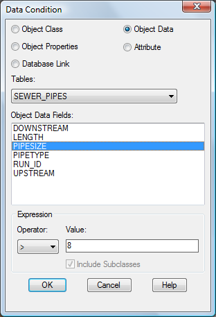

To create a query based on object data
Specify sewer pipes that are more than 8 inches in diameter.
Only the sewer lines that are greater than 8 inches in diameter are displayed.
