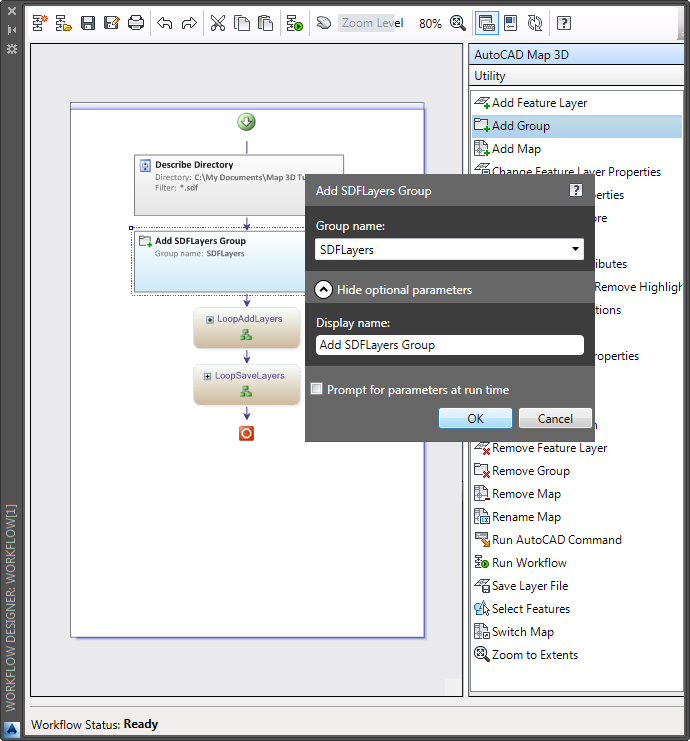

The new Add Group activity creates a group to hold the new layers. Since the LoopAddLayers activity adds layers to the group, the group must be created before the looped activity begins.
Drag the Add Group activity just above the LoopAddLayers activity and change its parameters.

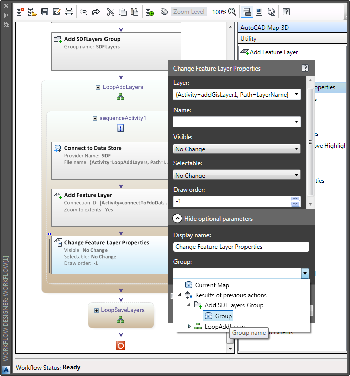

Because you want to change the Group property for each layer you add, place this activity inside the ForEach activity called “LoopAddLayers.”
By selecting the output of a previous activity, you are “binding” the current activity to its predecessor. The result of the previous activity does not yet exist in the current map. Binding allows you to specify a layer that will be created when the workflow is run.
Click the down arrow next to the Layer field and, under Results Of Previous Actions, expand the Create Layer activity and select Layer.
Expand the Show Optional Parameters section. Click the down arrow next to the Group field and, under Results Of Previous Actions, expand the Add SDFLayers Group activity and select Group.
Drag the Change Feature Layer Properties activity inside the LoopAddLayers activity and place it just after Create Layer. Change its parameters to specify the layers to change and the group for the layers.
