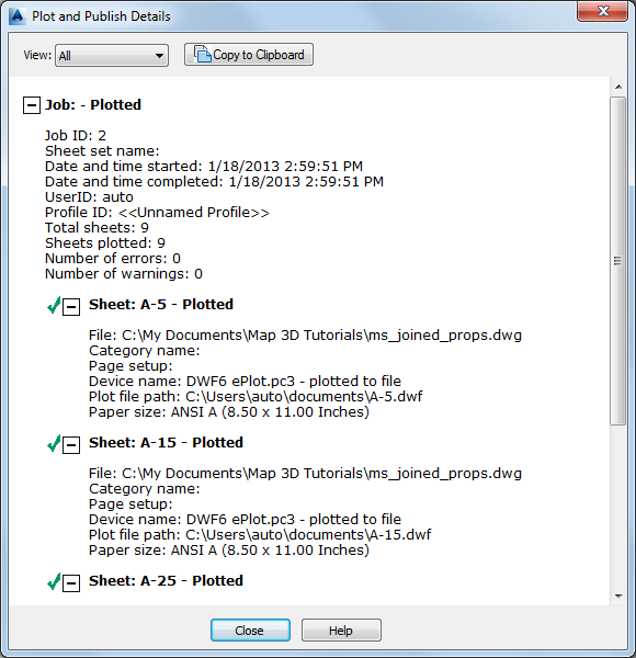

When the job is finished, a message alerts you to any errors.
You can view the details
