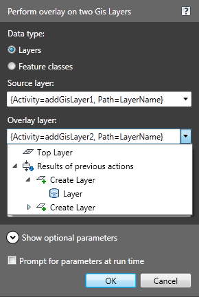

To use a layer created by a previous activity, select it from the list under Results Of Previous Actions.
There is a shortcut for adding an activity and automatically binding it to the previous activity. Right-click an activity and click the activity to add. For example, right-click an Overlay activity and click Add Feature Layer to create a new Display Manager layer that stores the output of the Overlay operation.
When you right-click, the list contains activities that would logically follow the current one. When you add an activity in this way, you can automatically bind it to the one you right-clicked. For example, right-click an Overlay activity and click Add Feature Layer to create a new Display Manager layer that stores the output of the Overlay operation.
When the run-time prompt is on, anyone running this workflow must provide the input for this activity. For example, the person running the workflow must provide data store connection information for a Connect To Data Store activity.
