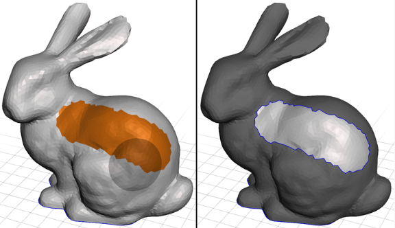

The Separate tool disconnects the selected triangles and places them in a new Mesh scene object. An example is shown below. This tool can take multiple disconnected selection regions, but all the regions are appended to a single new Mesh object. If you want to disconnect them into separate shells, use the Separate Shells command.
