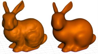

The Smooth tool is one of the original Meshmixer tools. Although it is quite simple, you will find that it often serves as a sort of "magic eraser" that can resolve many artifacts that other tools (Meshmixer or otherwise) might leave behind. The image below shows the basic premise behind the Smooth tool. Within the area(s) you have selected (in this case the entire bunny), details are smoothed out. Sometimes we think of this as the objet being "melted".

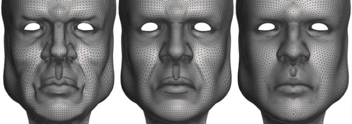

The image below shows an initial mesh, then default smoothing for Shape Preserving (middle), and Uniform Triangles (right). In this case, "Shape Preserving" actually refers to the shapes of the individual triangles, not the 3D shape. Notice in the middle image that the shapes of triangles are much closer to the original, compared to the right image, where the triangles are (at least locally) much closer to "regular" triangles. The only reason to use Uniform Triangles mode is if you are in fact more concerned with regularity of the mesh than the surface smoothness.

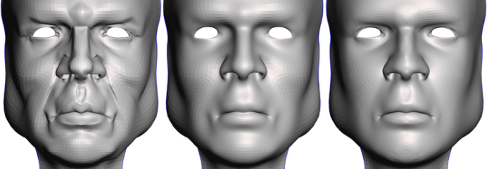

Here are the same meshes as above, with shaded renderings. You can see in the Uniform Triangles surface (right) that the cheeks have been smoothed more than in the middle image, but around the eyes there is less smoothing. Essentially, the Uniform Triangles mode is sensitive to the triangle density. It will smooth less where there are more triangles. The Shape Preserving mode compensates for this behavior, and as a result the "amount" of smoothing is more consistent across the surface.

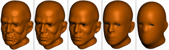

In our Smoothing algorithm, we have a notion of a sort of "feature size" which we would like to preserve. Features that are "larger" than this size should keep their shape, while smaller details can be smoothed. The Smoothing Scale parameter (approximately) controls this size. Unfortunately, this scale cannot be directly specified as a world-space dimension. The effect of the numeric Smoothing Scale is relative to the mesh density. If you have the same surface at different mesh resolutions, you will need to use higher scale values to see the same amount of smoothing. So, our numeric slider takes values between 0 and 100, with 0 being effectively no smoothing and 100 being as-smooth-as-possible. Below we show increasing the Smoothing Scale left-to-right.
Although the Smoothing Scale slider only goes up to 100, you can also halve/double this value using the left/right Arrow keys, which gives you 8 steps up from the default that you can quickly explore, before any necessary fine tuning. The q hotkey will also immediately set this slider to maximum smoothness.

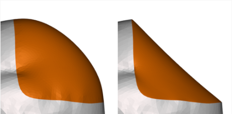

By default, we attempt to maintain tangent continuity at the edge of your selected region. As a result, even when you set the smoothing level to very high, the shape should remain rounded if the boundary is rounded, as in the image below-left. This is actually implemented by adding "soft constraints" on rings of the interior triangles, to blend between smoothed and not-smoothed positions. The Constraint Rings slider controls the number of rings. The most common use is to reduce this to 1, in which case the boundary constraints become position-only constraints, and we no longer try for tangent continuity. This produces flatter shapes, as shown below right.

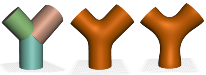

Although the most common use for Smooth is probably to massage non-smooth regions in 3D scans, Smooth is also a very powerful tool for 3D shape design. Essentially you can use Smooth to create very refined versions of your input meshes, with arbitrary constraints specified by non-selected regions. Below is a simple example, where we have three input cylinders that have been combined with Boolean operations. A quick smooth allows us to create a proper blend between these cylinders, in just a few seconds.

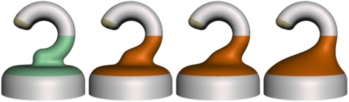

The images below show another example, where the leftmost hook is exported from a B-Rep Solid Modeling CAD tool. We designed the hook with simple shapes and then used Fillet operations to create rounded edges, however we could not make the Fillets any larger. After exporting to Meshmixer, we can use Smooth to quickly explore a wide range of transitions. In this case you can think of Smooth as a sort of Magic Auto-Loft. Note that Plane Cut is quite useful to create face groups for this kind of operation.
