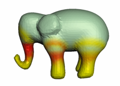

The Strength tool predicts and identifies regions of low structural strength that might be prone to breaking. It does so by computing a number of cross-sections of the model, and performing some analysis based on simulated forces at each of those cross-sections. Weak areas are rendered in red, stronger areas in green.
Show Sections displays the cross sections used during the analysis.
