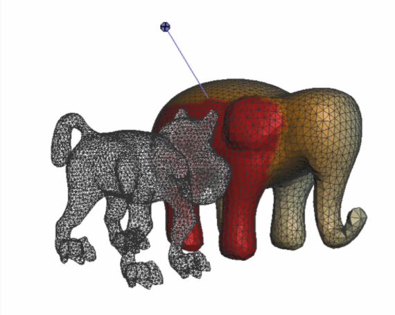

To use this tool, first select one object, then another, then click the Clearance tool. We will call the first object you select object A, and the second one object B. The tool will take each vertex on object A and find the closest point on object B, and record the distance to this point.
The Min Clearance slider is threshold distance. Vertices on object A that are closer to object B than this threshold are rendered in red. As well, the minimum vertex-to-surface distance is displayed as Min Distance in the UI.
