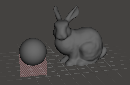

Show Grid
The ground-plane grid in Meshmixer can be toggled on/off with this menu item. Meshmixer uses a dynamic grid which changes resolution as you zoom in, as shown in the image below. The base dimension of the grid squares is found by clicking Actions menu > Unitsto open the Units/Dimension property panel, and reviewing the Grid Size setting.
Showing the grid
