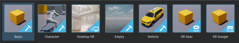

The 3ds Max Interactive editor ships with a few sample projects to help you get started. You can start a new project based on any of these templates in the Project Manager when time you start the editor. Select the Templates tab in the Project Manager to see the templates you have installed.
You can find video walkthroughs of the templates here.
The best way to start a new project is always to clone an existing one, like the Basic project, rather than starting completely from scratch. This ensures you have the correct project structure built in when it's time to compile your project.
If you want to start with nothing in your project, use the Empty project to start.
Tip: To change the project thumbnail that displays for your project, replace the thumbnail.png image in the sample project folder. The default project thumbnails are 512 x 512 pixels.
This template has a basic level with units and shows simple FX, shaders, and meshes in a simple shading environment.
It also includes a basic script that lets you spawn a free camera and a walk around camera, then swap between the two by pressing F2.
This template includes a basic shooter level with an animated 3D character. It's set up using Lua script. It has an animation controller, simple character animation examples, and the Lua script in player.lua that shows how they are all hooked up. The character shoots a simple physics-based projectile.
This template defaults back to core/appkit and loads minimal level with a simple camera.
This template is a simple vehicle level. It contains a driveable four-wheeled vehicle and the accompanying Lua script to set up the vehicle and the driving physics.
