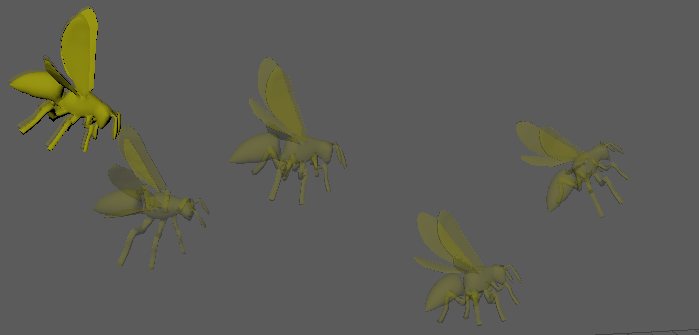

Ghost an object
Ghost objects let you see how an animation moves through a scene. Unlike Motion Trails, which simply uses a line to illustrate where an animated object moves, a ghost object shows a transparent representation of the object at the points in time you specify.
Note: You can only ghost a mesh that is transformed and keyed, you cannot ghost meshes that are passive but driven but another animation, for example, a constraint, deformer, or joint. You cannot ghost geometry that is not skinned.
