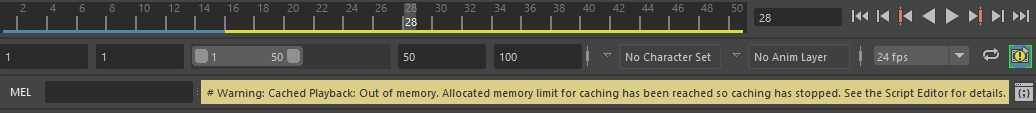

Cached Playback: warning state
If the Cached Playback encounters unsupported nodes or runs out of memory, Cached Playback is disabled, and the status line and icon turn yellow to indicate that caching has stopped. You can continue working, but you won't have any performance gains from using Cached Playback.
Safe Mode
This warning state triggers when Cached Playback encounters unsupported nodes so it is unable to send the animation to memory. Messages about what caused caching to stop are printed in the Script Editor.
For information about the times when Cached Playback might be disabled, see Cached Playback limitations.
Caching and Memory
Caching will stop if your system does not have enough memory (RAM) to support the process. If a memory shortage occurs, a warning message appears in the Help line. Change the amount of memory Maya assigns for Cached Playback or if you want caching to continue despite memory limits in the Cached Playback Preferences.
Cached Playback out of memory state
Note: You can continue to work even if Cached Playback stops. You just won't have any playback performance gains.
