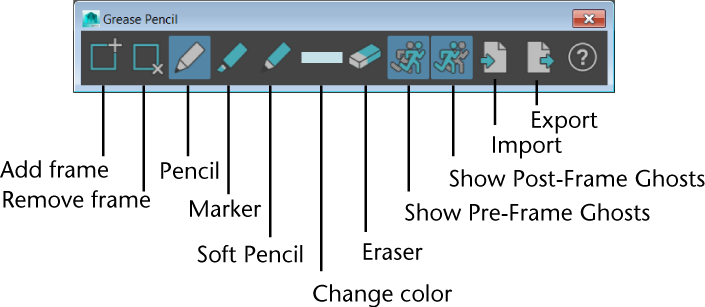

To open the
Grease Pencil tool, click the
Grease Pencil icon
in a panel toolbar or select
View > Camera Tools > Grease Pencil from the panel menus. See also
Grease Pencil overview and
Draw in the scene view with Grease Pencil.
Add frame |
Adds a Grease Pencil frame at the current time in the Time Slider. |
Remove frame |
Removes the sketch and the Grease Pencil frame at the current time in the Time Slider. |
Pencil |
Marker |
Soft Pencil |
Change color |
Click to open the compact version of the Color Chooser and change the tool color. Double-click to open the full Color Chooser. |
Eraser |
Erases brush strokes on the Grease Pencil sketch at the current frame. Note: If you're sketching on a Wacom device and you have the latest drivers installed, you can also erase using the stylus eraser.
Show Pre-Frame Ghosts |
Displays ghost sketches for frames before the current frame. See Control blending of Grease Pencil images. |
Show Post-Frame Ghosts |
Import Grease Frames |
Opens a file browser so you can update the scene with the images in the archive at the correct times. See Save and share Grease Pencil sketches. |
Export Grease Frames |
Creates an archive file that contains the scene's grease pencil images along with an .xml file that contains the image names and timings so other applications can use the data. This lets you share your grease pencil scenes. See Save and share Grease Pencil sketches. |
Help |
Opens the Grease Pencil help. |
