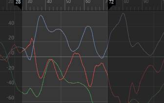

The Butterworth filter averages key frames using intelligent low-pass smoothing. It is a frequency filter that works best on curves affected by noise.
The Butterworth filter removes noise from data without affecting the curve's minimum or maximum values. In this way, the Butterworth filter avoids "over-averaging" problems that can happen when filtering motion capture data.

Time Range
Specifies the time range where the curve is simplified.
All
Simplifies the curve for the entire time range.
Selection
Lets you can select a portion of a curve, so you can apply the filter to a limited area, rather than affecting the entire curve. Hold Ctrl to select multiple areas at once.
Time Slider
Simplifies the curve for the time range defined by the Playback Start and End times of the Time Slider.
Start/End
All keys within the specified time range (start time/end time) are simplified.
