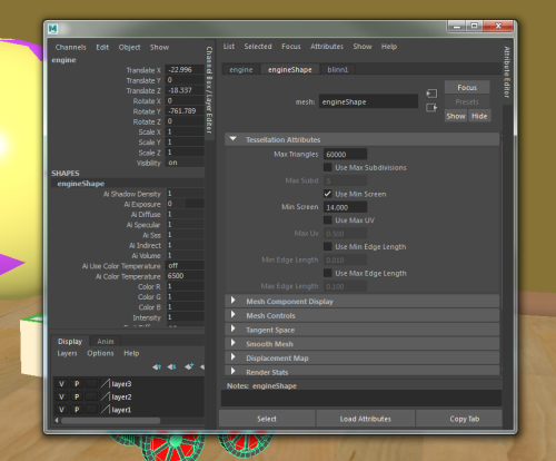

You can dock several panels together into a single floating window which you can then move around.
This is especially useful when you're setting up your editors on a second monitor. For example, you can dock the
Attribute Editor and
Channel Box together and keep them on another monitor to maximize the working space in the view panel.

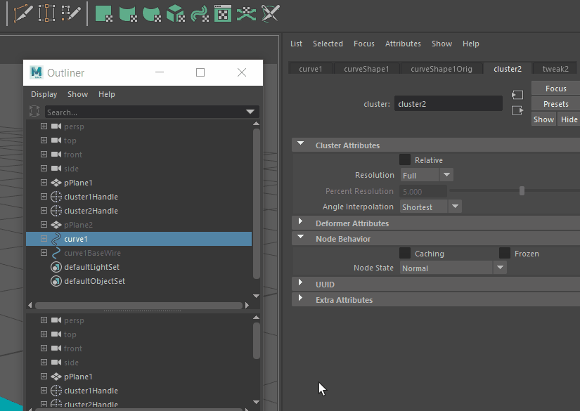

- Open any panel or editor in a floating window, or undock it so that it is floating.
Drag another panel onto an edge of the panel in the floating window.
To create a tab deck if one does not exist yet, drag the panel to the upper-left corner of the panel in the target window until a blue triangle appears, then release the mouse button.
