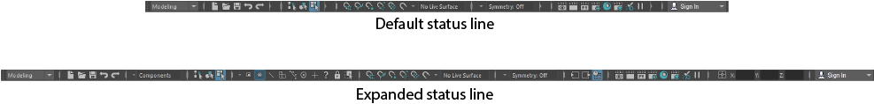

Status line (toolbar)
The Status line lets you:
Tip: By default, parts of the Status line are collapsed. Click the show/hide buttons to expand hidden sections.
