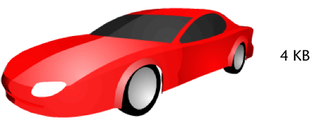

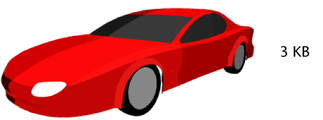

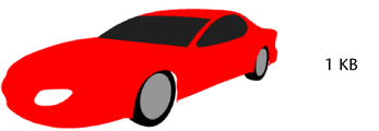

Fills each surface with one solid color based on the surface material color.
Single Color can produce nice cartoon-like results, especially when your model is composed of separate surfaces that each have a different colored material.
The Single Color fill color is actually based on the surface material color and an ambient light (located at the camera) that is automatically created during rendering (and removed after rendering). Therefore, the fill color may not exactly match the surface material color. The fill color should not change during an animation.
For better definition of surface edges, turn on Edges.
Fills each surface with two solid colors based on the surface material color and on scene lighting.
Two Color produces results that look slightly more 3D than Single Color, but also produces larger file sizes.

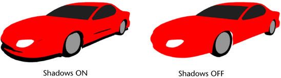

Object shadows are rendered (based only on shadow-casting point lights in your scene). Shadows can greatly enhance the 3D effect. However, shadows also increase file size and significantly increase render time.
When Shadows is turned on, shadows are rendered for all objects. You cannot render shadows only on certain objects (for example, by turning off Casts Shadows or Receive Shadows for an object).
Shadows are only rendered if there is a shadow-casting point light in your scene (that is, a point light that has Use Depth Map Shadows or Use Ray Trace Shadows turned on).

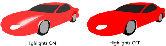

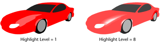

Specular highlights are rendered (based only on point lights in your scene and on surface material shininess). (When Fill Style is Single Color, specular highlights are based on the position of point lights in your scene. Changing the intensity or color of point lights does not change the appearance of highlights.)
Regions of surfaces that are close to being perpendicular to a point light are filled with a number of concentric solid color regions (based on surface material Specular Color and on the Highlight Level value) that are lighter than the rest of the surface.
| For this material... | Surface shininess is based only on... |
| Anisotropic | Roughness |
| Blinn | Eccentricity |
| Phong | Cosine Power |
| Phong E | Roughness |
The number of concentric solid color regions used to represent specular highlights. The valid range is 1 to 8. The default value is 4.
This option is only available when Highlights is on.

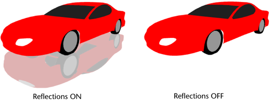

Surface reflections are rendered (based on the surface material Reflectivity).
The maximum number of times a surface can inter-reflect with other surfaces. The valid range is 1 to 4. The default value is 2.
This option is only available when Reflections is on.

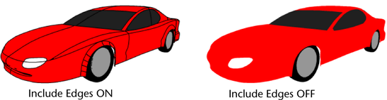

Surface edges and silhouettes are rendered as outlines.
To render surfaces as unfilled outlines, turn off Fill Objects and turn on Include Edges.

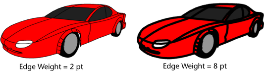

The thickness of surface outlines (measured in points).
When File Format is SWF, changes in Edge Weight less than 1 Point are not noticeable unless you zoom into the outline.

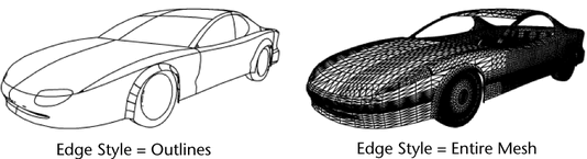

When Edge Style is Outlines, surface edges and silhouettes are rendered as outlines. (Use Detail Edges to also render sharp polygon edges as outlines.)
When Edge Style is Entire Mesh, all polygon edges are rendered as outlines. Entire Mesh produces very large file sizes. (The greater the number of polygons in your model, the greater the file size.)

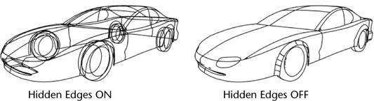

Surface edges that are behind another surface are visible in the rendered image. (This may make certain objects look transparent or make models appear as wireframes.)
Hidden Edges increases rendered file size because of the extra vector information.
If you are rendering a model with many polygons, avoid turning on Hidden Edges and setting Edge Style to Entire Mesh; too many lines will likely appear in the rendered image.

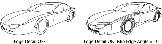

Sharp edges between polygons are rendered as outlines. The Min Edge Angle controls which polygon edges are rendered as outlines.
Edge Detail can help define the shape of a 3D object, especially when the object is composed of few surfaces, but also produces larger file sizes.
This option is only available when Edge Style is Outlines.
When you turn this attribute on, an outline appears along the point where two objects intersect. Use the Edge Priority setting to resolve edge outline conflicts (when depth does not automatically do so). This attribute is also located in the Vector Renderer Control section of a material's Attribute Editor.
Determines which polygon edges are rendered as outlines when Edge Detail is on. Min Edge Angle is the minimum angle (measured in degrees) that two adjacent polygons’ normals must have in order for their common edge to be rendered as an outline.
Decreasing the Min Edge Angle produces larger file sizes because of the extra vector information in the rendered file.
