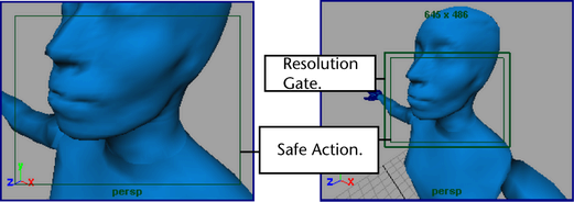

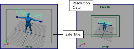

To display the safe action and safe title guides, select View > Camera Settings > Safe Action and Safe Title.
The safe action view guide represents 90% of the rendering resolution (the resolution gate).
The safe title view guide represents 80% of the rendering resolution (the Resolution Gate). For example, in this image, the title DANCER does not fit within the Safe Title area. Track the scene until the title fits within the border.
