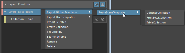

When importing, global templates and user templates are listed via separate right-click menus. You can create sub-folders inside a template directory, and these subfolders appear as submenus in the right-click menus. In addition, you can mouse over the listed templates, and the notes that are saved with each .json file appear as a tooltip. See Global templates and user templates.

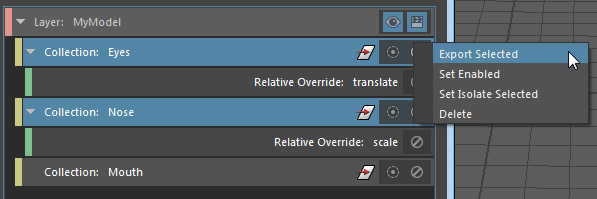

To export a collection or override, select the item and select File > Export Selected. You can optionally add comments to the Notes field.
When you export a collection, all of its associated overrides, along with your notes, are automatically included in the exported .json file.
To import a collection, you must navigate to a render layer and right-click to select the template file that you want to import. Only template files of a compatible type are listed. Therefore, if you right-click on a render layer, only template files that contain collections are listed. Template files that contain an override, for example, are not listed.

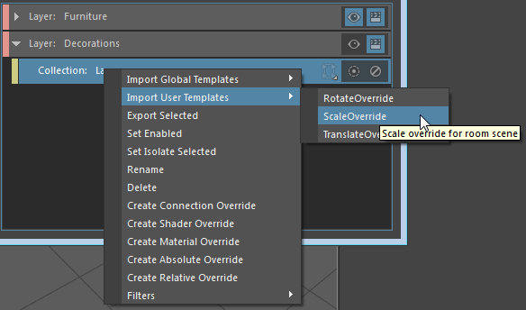

Similarly, to import a render override, you must navigate to a collection and right-click to select the template file that you want to import. Only template files of compatible types are listed.
For convenience, you can also select the item(s) that you want to export, right-click and select Export Selected. The File browser appears, allowing you to enter a file name and notes.
If you select multiple items, this menu item only appears if the items that you select are of the same type.

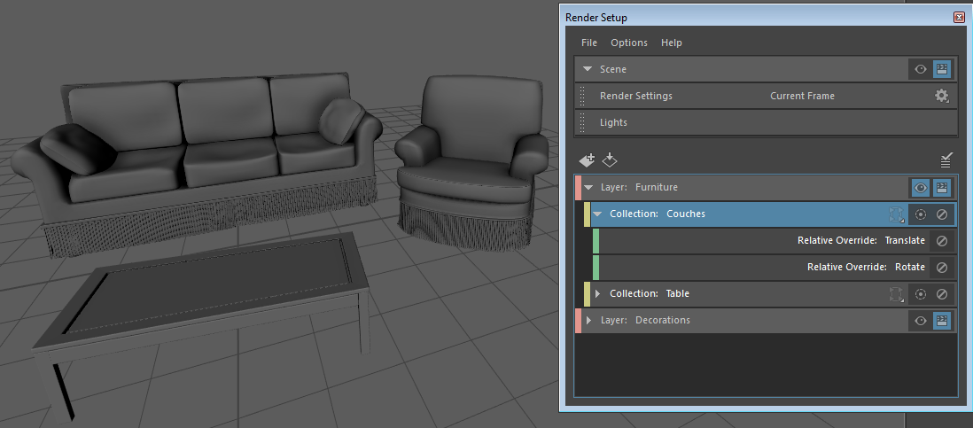

Select Couches to export the Couches collection, and its translate and rotate overrides are included with the exported template. You can also export only an individual override; for example, translate.
Right-click a layer, and only templates of type collection are listed in the menu. Override templates, for example, are not listed here. A subfolder RoomSceneTemplates exists inside the global templates directory, and thus a submenu is created accordingly.
Right-click a collection, and only templates of type override are listed in the menu. Other .json files, such as those you exported by selecting File > Export All, are not listed. Notes that are saved with the .json appear as tooltips for easy identification.

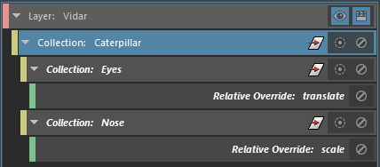

You can export a collection (or multiple collections), and import them as subcollections in a different scene.
In this example, the Eyes and Nose collections are exported as a .json.
These two collections are then imported as subcollections of the Caterpillar parent collection, and their associated overrides imported also. This way, the caterpillar model appears in the layer, and its eyes can be translated and its nose scaled.
