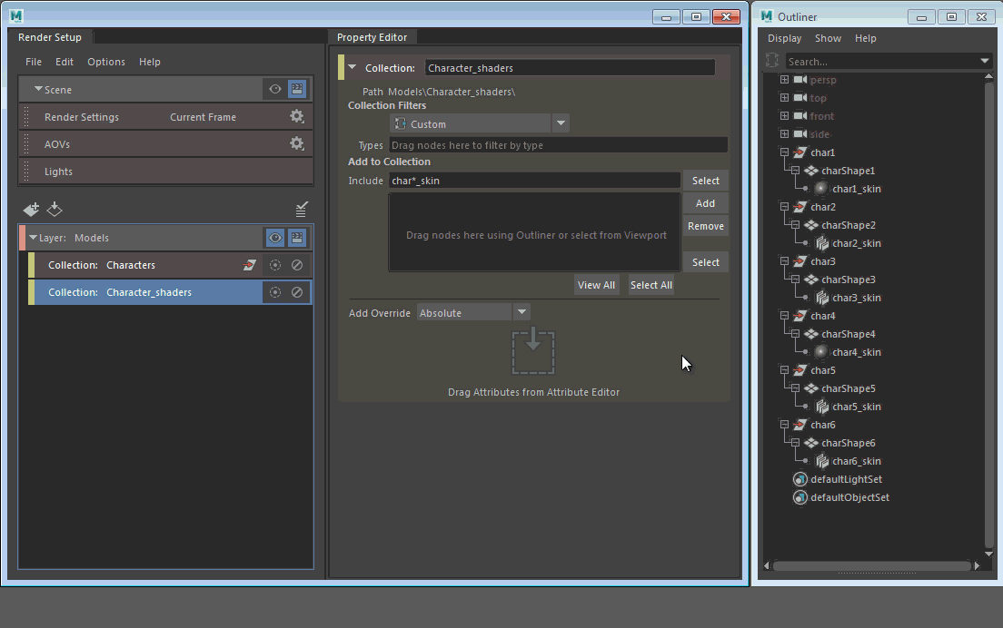

If the Collection Filters provided are too generic for your purpose, you can streamline your collection even further by using the Custom filter to include only specific node types of your choice. Select Custom from the drop-down menu and add node types to the Property Editor Collection Filters Types attribute. To add node types, middle-mouse drag and drop a node from the Outliner to the Property Editor, and its node type is automatically recognized. Plug-in node types are recognized.
In the following example, the char*_skin expression is used to include all the character skin shaders in the collection. Now when you middle-mouse drag char1_skin to the Property Editor Types attribute, the blinn type is recognized. Likewise, when you middle-mouse drag char2_skin to the Property Editor, the aiStandardSurface type is recognized. Click Select All to verify the membership.
