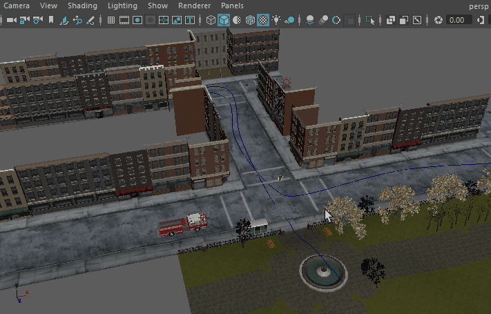

Look through a camera
If you have more than one camera, you can switch the camera through which you are viewing the scene.
To look through a camera
  1. Do one of the following:
    • To look through a selected camera, click Panels > Look Through Selected (this also works with objects).
    • To look through another camera, click Panels, then select the camera name from either the Perspective or Orthographic submenus.
Note: Like cameras, an object's position in the scene will be affected by dollying, tumbling, or zooming while looking through it.
