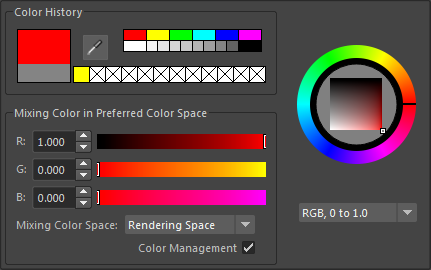

Specify numeric color values in a Color Chooser
When color management is enabled, Color Chooser windows and pop-ups let you specify numeric color values in different color spaces.
For example, if your View Transform is sRGB gamma and you are given exact sRGB values to use for a particular color, then you can set Mixing Color Space to Display Space and enter those values directly, without worrying about how to convert them into your rendering space.
If you toggle off Color Management in the Color Chooser, then the raw numeric values are stored and the color controls are displayed without applying the view transform.
In any case, the stored numeric values are always interpreted as raw values in the rendering space. This means that the values might get interpreted differently if you change the Rendering Space in the preferences at a later time.
