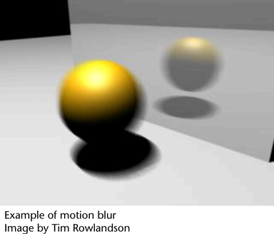

Motion blur gives the effect of movement by blurring objects in an animated scene.
You can enable and adjust motion blur for your entire scene, or for specific objects. If some surfaces in the scene don’t move, or move only slightly, do not enable motion blur for them. Adjusting settings on a per-object basis is often faster and has less of an impact on rendering speed.
