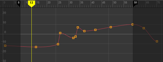

Red curves
Red curves indicate animation on the X-axis, whether it be Translation, Rotation, or Scale animation. Red in Maya is used to represent the X-axis.

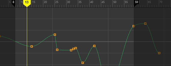

Green curves
Green curves indicate animation on the Y-axis, whether it be Translation, Rotation, or Scale animation. Green in Maya is used to represent the Y-axis.

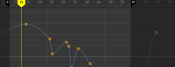

Blue curves
Blue curves indicate animation on the Z-axis, whether it be Translation, Rotation, or Scale animation. Blue in Maya is used to represent the Y-axis.

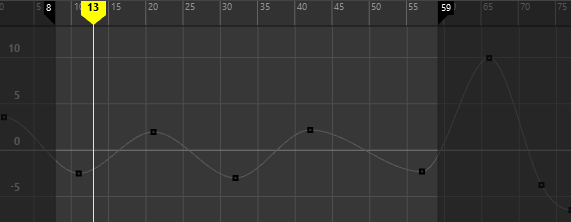

A grey curve with black keys is a curve that is Locked.

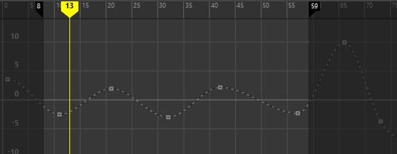

A dotted-line grey curve with grey keys is a Muted curve.

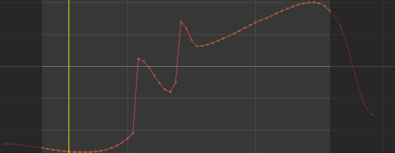

Baked channel
Baking a channel puts keys on every frame of the curve. See Bake Keys for more.
