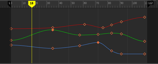

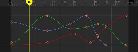

Normalized View
Note: Known as Display Normalized in the Classic Graph editor.
Press 3 to activate Normalized View.
When on, this option scales down large key values or scales up small key values to fit within a -1 to 1 range. When animation curves are normalized, they are adjusted to fit within the range of normalization.
Curve normalization is useful when you want to view, compare, or edit animation curves that are related (such as rotation and translation curves), but have drastically different ranges. For example, with curve normalization you can compare all the translation and rotation animation curves for an object.
When you turn Display Normalized off, the curves revert to a non-normalized state, back to their original ranges.
Note:
Animation curves that are normalized appear thicker than other curves in the Graph Editor.
