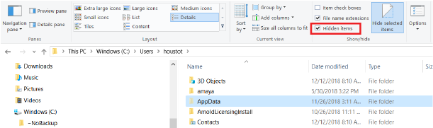

To show the AppData folder in
Windows 10
- In the Windows File Explorer, click the View tab.
- In the Show/hide section, activate
Hidden Items.

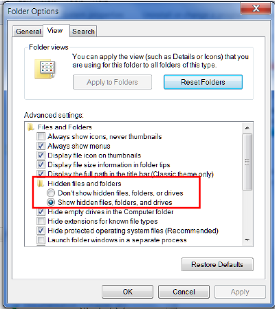

Windows 7
- In the Windows File Explorer, choose Tools > Folder Options.
- In the Folder options window, click the View tab and locate the entry for Hidden files and folders.
- Activate the
Show hidden files, folders, and drives option.
