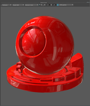

You can add image based lighting to your render in the Hypershade Material Viewer. Choose from the provided preset HDRI environments or add your own. This feature allows you to see how your object reflects and refracts in different environments.
Select any of the options from the preset environment drop-down list.
For each preset, a color and a neutral option are provided. The two have the same intensity, but the neutral option is without color so that the environment does not influence the shading of your object.
When using the Hardware renderer, the HDRI environment affects the material swatch, but the environment is not shown in the background.
