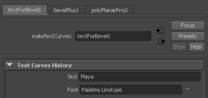

Change the following:
// String set: s_TdnTextCurvesStrings // s_TdnTextCurvesStrings.rTextCurvesDefaultFont = "Times-Roman" s_TdnTextCurvesStrings.rTextCurvesDefaultFontLong = "Times New Roman" s_TdnTextCurvesStrings.rTextCurvesDefaultFontWAttr = "Times-Roman|h-13|w400|c0"
to something similar to the following:
// String set: s_TdnTextCurvesStrings // s_TdnTextCurvesStrings.rTextCurvesDefaultFont = "NimbusMonL-Regu" s_TdnTextCurvesStrings.rTextCurvesDefaultFontLong = "NimbusMonL-Regu" s_TdnTextCurvesStrings.rTextCurvesDefaultFontWAttr = "NimbusMonL-Regu"
