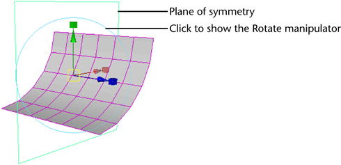

You can model a polygon mesh and then copy it across a user-defined axis of symmetry using the Cut Geometry feature in the Mirror Options. The Cut Geometry feature lets you manually position the axis that the mesh will be duplicated across. You can see the copied mesh "mirrored" on the other side of the axis of symmetry, and then move the axis to slide the two objects together or apart, changing the shape and location of the intersection. You can delete the axis and the copied mesh to cut the original object along the axis. You can also merge the duplicated mesh with the original mesh to create one resulting polygon mesh. Cut Geometry can provide for interesting symmetry results depending on where you position the axis of symmetry.
