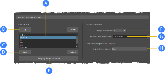

A. Rules list
Select a rule. You can edit the selected rule using the options on the right.
If you are using the default preferences, there are some preset rules in addition to the Default rule. The hdr and exr rules assign the input space of any file with those extensions to Raw. Unlike the Default rule, these are ordinary rules that have been added for convenience, and they can be edited, deleted, and moved up or down like any other rule.
B. Up, Down
Rules are applied in order from top to bottom. The input space specified by the first rule that matches is initially set as an image's Color Space attribute. Use the Up and Down buttons to move the selected rule.
C. Default rule
The input space specified by the Default rule is used when no other rule matches. You can only specify the input color space — you cannot specify a condition to match. The Default rule is always the last in the list and cannot be moved. If you choose not to define additional rules, you can set this to the color space used by most of your image files.
D. Add, Delete
Add a new rule to the top of the list, or delete the selected rule.
E. Reapply Rules to Scene
Reapplies the rules to change the Color Space attributes of existing image nodes in the scene. Image nodes with Ignore Color Space Input Rules checked on are not affected.
F. Image Extension
Specify the file extension to match in the selected rule, or use * for any extension.
G. Image File Path Pattern
Specify the pattern for the selected rule to match in the full path of an image file. Strings are case-sensitive, and use the so-called "glob" syntax for pattern matching.
String Pattern Example
? Any one character. ?pecular matches specular and Specular, as well as Xpecular and many others.
* Zero or more characters. *diffuse matches diffuse at the end of the path.
diffuse* matches diffuse at the beginning of the path.
*diffuse* matches diffuse anywhere in the path.
Tip: Put an asterisk at the beginning of every pattern so that image files get matched in any directory.
[chars] Any one of the specified characters. *[nN]ormal* matches normal or Normal anywhere in the path.
[char1-char2] Any character in the range. *[0-9] matches any path ending with a numeral.
[!chars_or_range] Any character except those specified. *[!0-9] matches any path that does not end with a numeral.
/ Escapes the next character, that is, treats the next character as a literal, instead of part of the pattern matching syntax. */[*/]* matches a pair of square brackets anywhere in the path.
H. Input Color Space
Select the color space to assign to files that match the selected rule.
