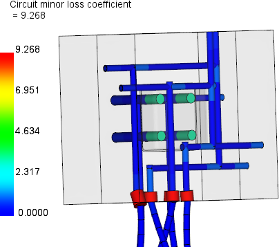

Circuit minor loss result
The circuit minor loss, or the K factor, is the resistance to flow that occurs in the cooling circuit as a consequence of every elbow, bend, T Junction, expansion, contraction, etc. To obtain an accurate result, enter the K factor for each circuit component, as provided by the component manufacturer. Otherwise, you can look up generic values in books, but the result is less accurate. If you don't enter a K factor, the solver calculates a generic value. If you enter a value, the solver ignores the generic calculation and uses the data you enter. Use this result to:
  • Compare the result against the result when the solver calculates a generic value, to see how accurately the generic value simulates your circuit minor losses
  • Decide whether to ignore the circuit minor losses
  • Verify whether the result is sufficiently accurate if you only specify the minor loss in a complex branch region, and let the solver calculate the minor losses in the rest of the circuit.
