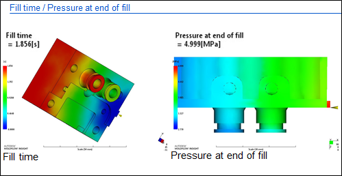

Use the TwoPlots command to add two different result plots to your report.
The format for the TwoPlots command is:
TwoPlots, <Plot Name>, <Orientation>, <Plot Name2>, <Orientation2>, or
TwoPlots, <ResultID>, <Orientation>, <Plot Name2>, <Orientation2>,
where <Orientation2> is an optional argument. If you use a saved view that you have created yourself, include quotation marks around the orientation argument.
