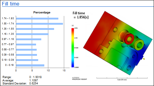

OneHistogramOnePlot
Use the OneHistogramOnePlot command to include in your report.
The format for the OneHistogramOnePlot command is:
OneHistogramOnePlot, <Plot Name>, <Orientation>, <Number of Bars>, <Show Statistics>, or
OneHistogramOnePlot, <ResultID>, <Orientation>, <Number of Bars>, <Show Statistics>
where <Plot Name> or <ResultID> is the only mandatory argument.
For example:
